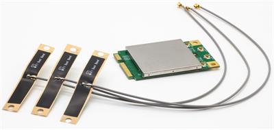

Turris RTROM01-WS3294
Why only three pigtails and why not AX?
Wi-Fi 6 is coming. Different card, we have showed it at MWC Barcelona.
So what are the reasons for offering this card?
Right, so we don’t have the old one in stock anymore, this one is a bit faster and so on.
Thanks for explanation. But this card is faster only with four pigtails.
True that, but the card is primarily considered for MOX and we needed to have it like this. You can add the 4th if You want, with diplexer, while drilling the hole on the Turris Omnia cover.
However Wi-Fi 6 upgrade kit is coming, so…I suggest You can wait for it.
And where I can buy the fourth one? I believe that, with a view to the future, four should already be available in the basic package.
How many diplexer will have AX upgrade pack?
Antennas with pigtails:
Diplexer: Turris Omnia diplexer | Discomp - networking solutions
As for the Wi-Fi 6, there will be 4 of them.
Thank you and I still think they should be part of the package!
Mkay. Are You planning to get Wi-Fi 6 kit? :smiling_imp:
At this time not. I haven’t AX compatible devices, but in future definitely!
It will available / compatible with Turris 1.*? :upside_down_face:
Now, that’s the question! The answer is - most probably, sounding yes…but, give us some time to work through it properly and then, to announce it :innocent:
Since we are an open-source project, let me explain a few things. In the previous mini PCIe pack (addon) for Turris MOX, we were selling Compex WLE900VX. This card is these days very hard to get. We can not wait until it is available. On top, some of you know that this card was and still could be problematic on Turris Omnia. There might be an HW issue/SW issue, and choosing between alternative firmware, which suits you better, can be time-consuming and not provide a good user experience. All these details were already discussed here on the forum.
We were testing multiple Wi-Fi cards, which we can use instead of Compex WLE900VX, so we would not stop the production of new units. We end up with card which uses mt76 driver. This driver should be more stable, and also it provides more features. Of course, I should not forget about higher Wi-Fi bandwidth, which this chip is capable of.
Since the previous card was 3x3, this one is 4x4. In the packaging, you can find only three antennas, and it does not matter how did you plug them since we continue to use it only as 3x3. If you would like to have four antennas, you are free to do it. These internal antennas are mostly for Turris MOX. If you want to use it on Turris Omnia, you don’t need to drill anything if you are not using an LTE modem or planning to get an AX card. There are already 5 holes (3 occupied already) in Turris Omnia, and you will most likely need additional antennas/diplexers (same applies for Turris 1.x).
In the future, as I said somewhere else, we are planning to provide and sell a Wi-Fi upgrade pack with AX (Wi-Fi 6) as we did it a long time ago for blue Turris 1.x with AC. We will announce it, don’t worry.
I don’t see why this card should not work for Turris 1.x routers. I’m currently using not officially supported by us - Mediatek MT7612E, which I was using with Turris OS 5.x and now with Turris OS 6.0. Anyway, If you would like to use this new card from this pack with Turris 1.x routers, you need to move spacers.
It will be added shortly to our FAQ.
TL;DR: This is a replacement for the out-of-stock Compex WLE900VX, and if you are planning to get AX (Wi-Fi 6) card, you should wait a little bit. :slight_smile: This was only for users who bought Turris MOX: Start or any other variant without Wi-Fi and then they decided to buy addons with Wi-Fi.
