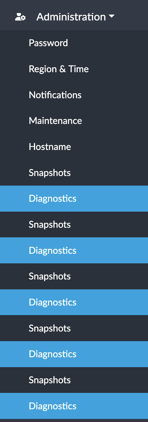

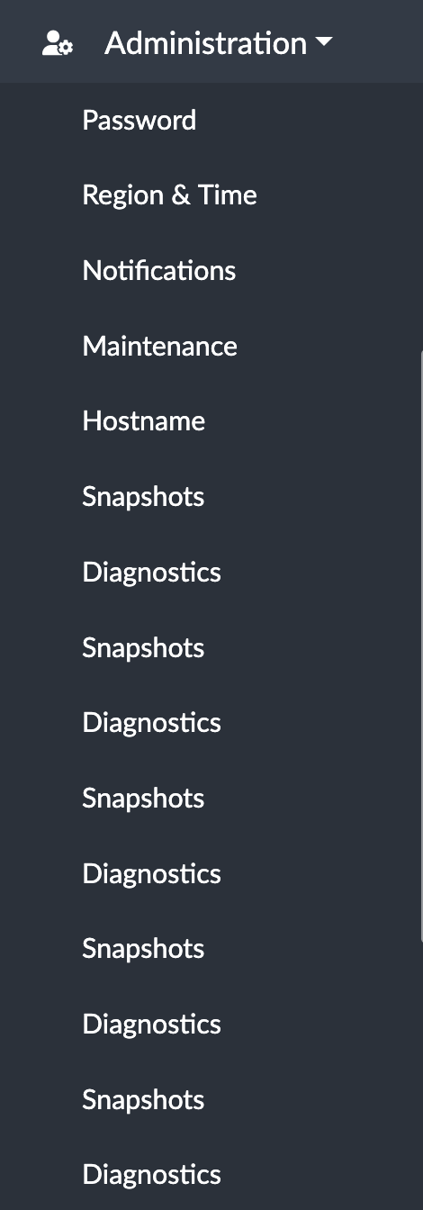

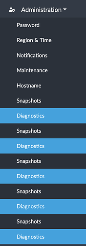

Under Administration, there are repeated entries.
When I selected one (Diagnostics in this case):
This seems to be merely cosmetic.
I guess your reforis needs a Ctrl+F5.

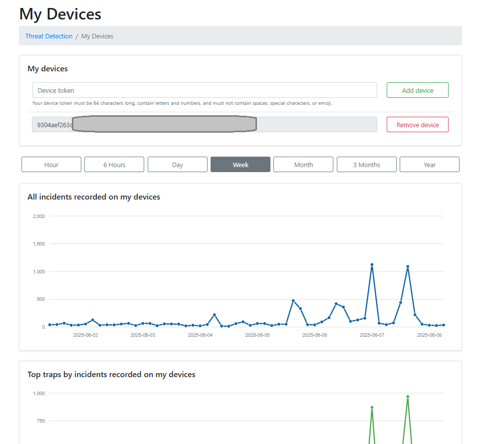

I have “Haas” set up correctly including the token set up, why is “threat detection” in the off state?
It seems to be a bug on the reForis Overview page. I’ve created an issue for it and it will be solved.

I have exactly the same observation. After 10/24 the number of incidents went almost to zero. Is the whole thing working? All services seem up and running.
Same issue here with threat detection disabled
