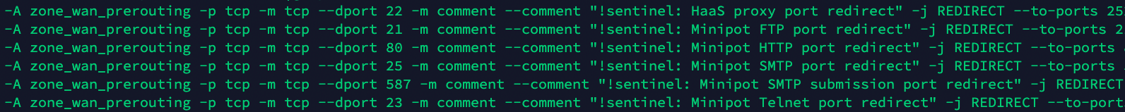

You can check the specific firewall rule by
iptables -t nat -S|grep sentinel
or
iptables -t nat -S|grep 2525
Should look like below for HaaS
-A zone_wan_prerouting -p tcp -m tcp --dport 22 -m comment --comment "!sentinel: HaaS proxy port redirect" -j REDIRECT --to-ports 2525

The output seems to be correct. I think it must be some bug or problem on the HaaS site? or maybe tied to my current account for HaaS.

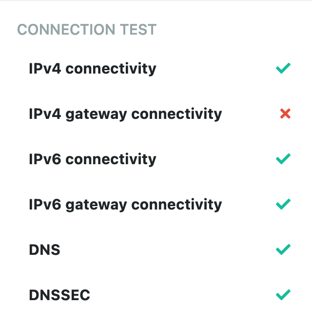

I have noticed this output just now in overview → Connection Test
“IPv4 gateway connectivity” → red cross.
I am not sure what this indicates since SSH → check_connection reports no issues. So what does the gateway check indicate?
UPDATE: I tried to change my DNS resolver from DoT to normal ISP DNS but this doesn’t change ‘gateway connectivity’ status. Does it just mean it cannot connect to my ISP modem with an IP address? My connectivity seems fine overall.
It is gateway of your ISP.
