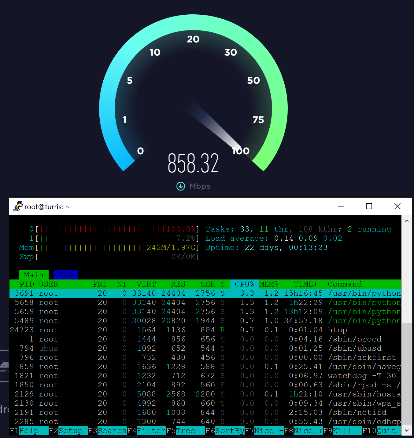

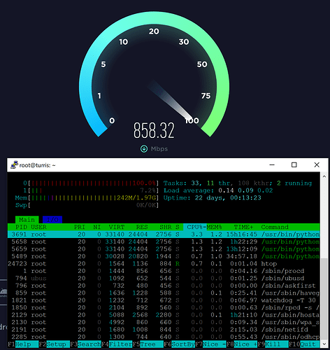

Turris 6.0 - download speed capped at 860 Mbit/s
After upgrading from 5.4 everything worked without any configuration changes.
However, the download speed does not go over 860 Mbit/s, and top shows 100% usage on one cpu.
On TOS 5.4, I was able to reach about 930 Mbit/s and both cpus were at about 50%.
I am using an SFP GPON adapter to connect to the internet, in case that matters.
Is there something I have to change in the configuration or is this a known issue?

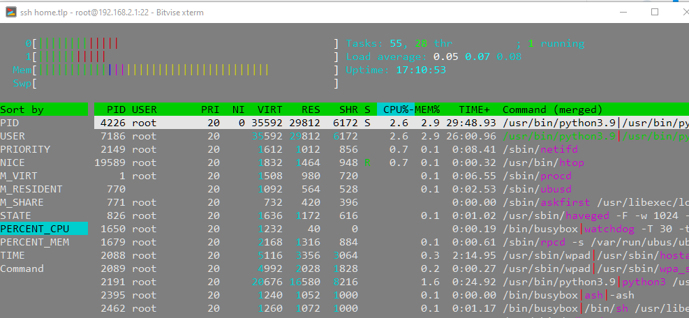

I’d look at htop and see what’s consuming your stress power there.

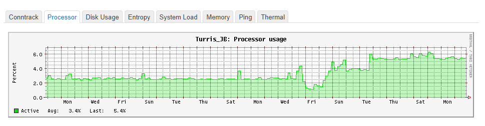

My idle CPU load also increased with version 6

It was the web version of speedtest.net from my computer, that accesses the internet through the router.

Just like top, htop only shows increased cpu usage, but nothing that uses it.
I think the problem here is that only 1 cpu is used.

I see in htop exactly the processes sorted by CPU power requirements

The browser version of Speedtest works well enough for me. Previously, I almost always got something around 930 and now it’s always around 860.

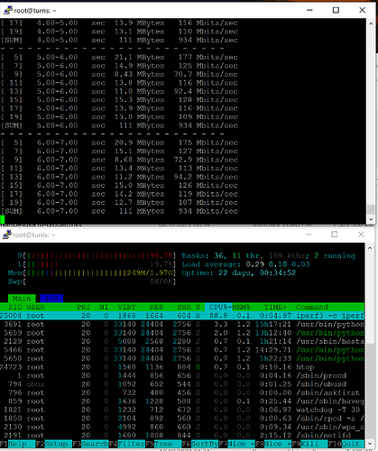

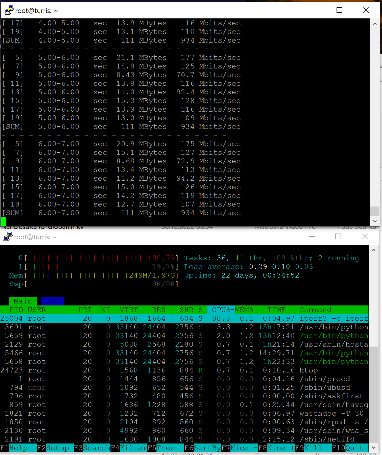

If one CPU is at 100%, I don’t think the speed can go any higher without some additional change:

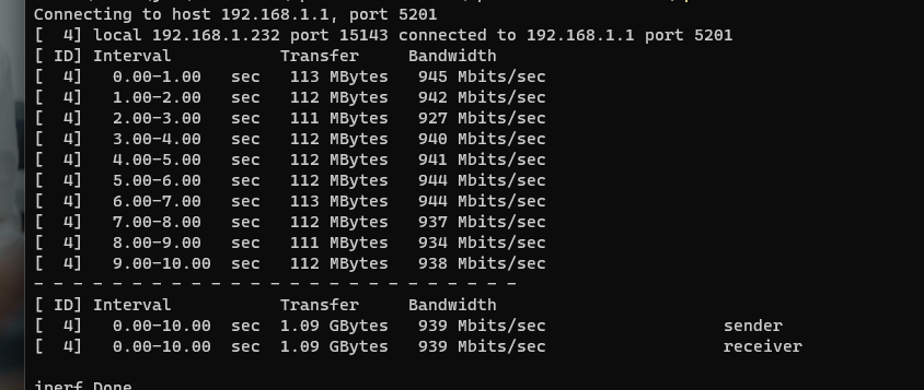

Indeed, when running iperf3 from the router to a server on the internet the speeds were higher:
Maybe because less CPU was needed?
