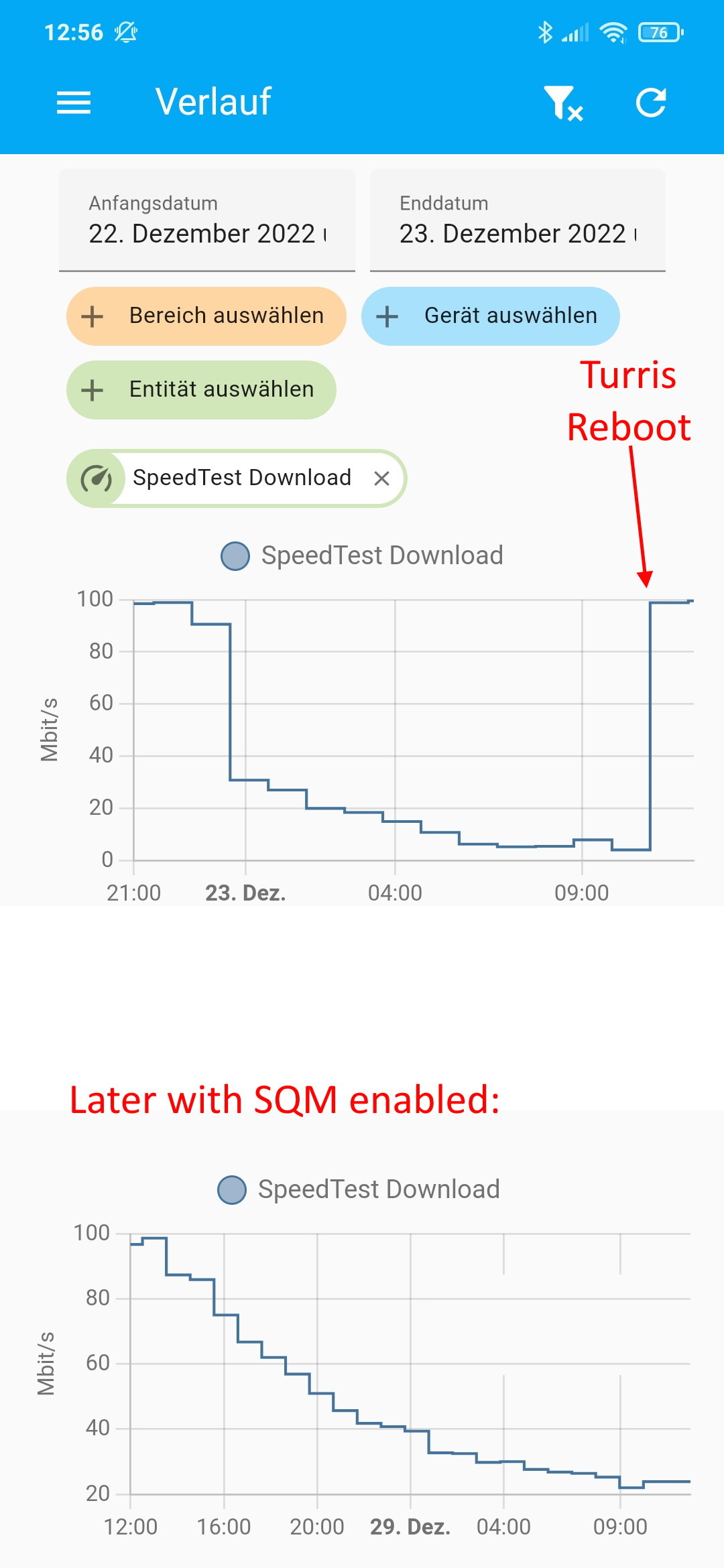

I have a strange behaviour I’m trying to get rid of for some weeks, but cannot get over it.
I have a Turris Omnia with OS 6.1. ISP is a Fiber network with 100MBit downstream an 10MBit upstream.
When Turris starts up everything is fine. Then over some hours the downstream get slower and slower and the latency increases. Tried with SQM (bufferbloat) but that did not help.
Measured speed over time (with my homeassistant):
Now the real strange thing is, that only the LAN connected computers suffering from this. Tries speedtest-cli from the turris itself (via SSH) show full speed.
When I reboot the Turris everything is fine again for some hours.

Found out, that Turris itself degraded like the LAN too, if SQM is enabled. Disabling it immetiately releases full speed, but only for the Turris, not for LAN.
