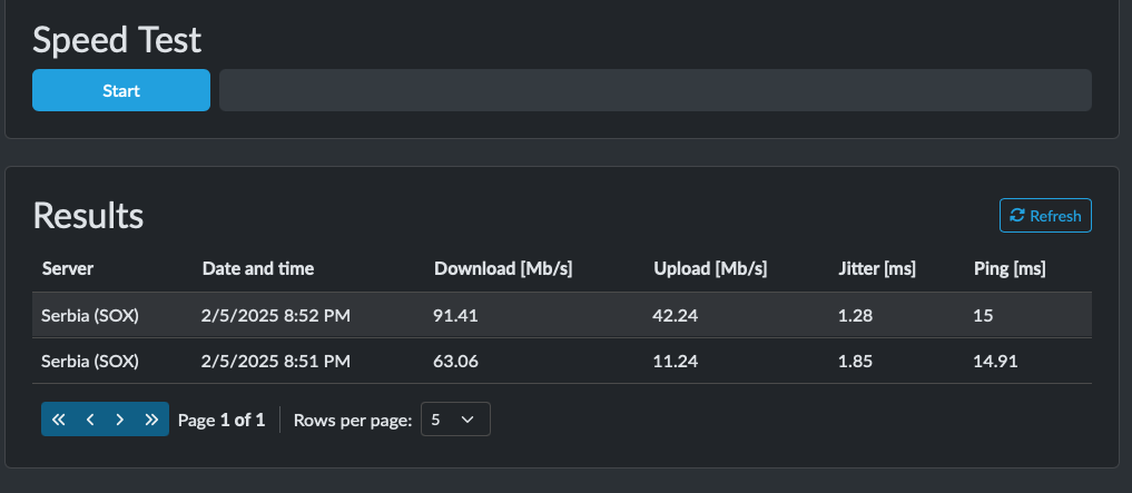

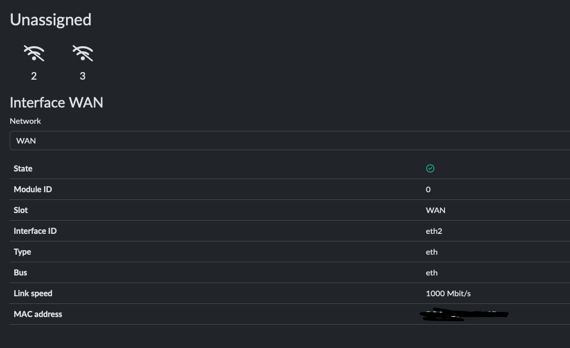

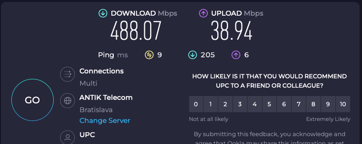

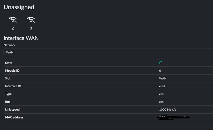

i might have the same problem. port speed is shown as 1Gb also on modem side byt librespeed and speedtest show 100/50, my line is 600/50…after reeboot ig works fine for few days…tried different cables, modem reboot (docsis modem) even did factory reset on omnia… i have turris omnia, hbs 7.1.3
Test were run 2 minutes appart, fresh after reboot
Keep in mind that there are less LibreSpeed servers and they are slower.
I fed up on using it because it was not showing the full bandwith. I like the idea but unless there are more faster servers its there just as a refference and not that you should judge the actual link speed.
I know. When the issue occurs after same time, speedtest and librespped show same around 100mbit speed.
