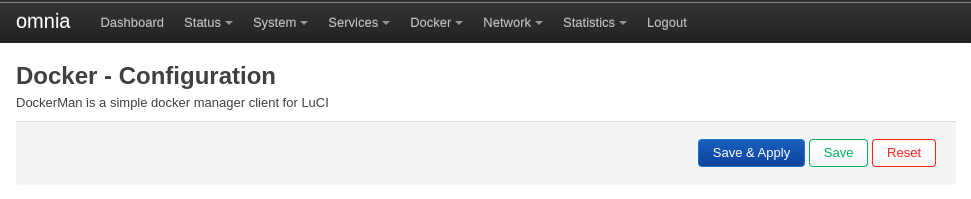

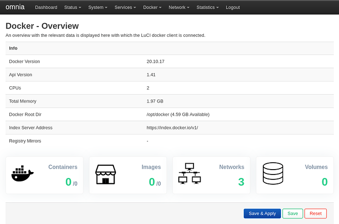

After updating to TOS 6.0 I’m eager to try out docker however I’m reluctant to start deploying containers as the Docker Root Dir is set to /opt/docker.
Docker configuration page is empty however and remains so after reboot and docker re-installation.

Also Docker > Overview does not allow changing the Docker Root Dir. That’s why I mentioned that Docker > Configuration is empty in the OP.

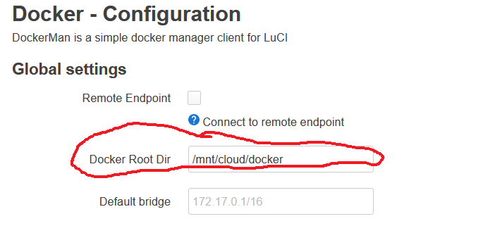

Based on your solution for dockerman here is what I can see in my dockerman configuration page. Don’t you have this configuration page? The root dir is editable.
docker
So finally I see where I have changed the root dir, it is at /etc/config/dockerd
option data_root '/mnt/cloud/docker

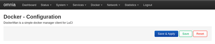

No my docker configuration page is empty and remains so even after completely removing and re-installing dockerman.
I checked /etc/config/dockerd and it was empty for some reason. So I uninstalled dockerman, dockerd, and docker and reinstalled them again. I got an error saying that /etc/config/dockerd was different than the packaged one and the new one is at /etc/config/dockerd-opkg.
I deleted the dockerd file and renamed dockerd-opkg to dockerd and restarted the dockerd service.
Dockerman configuration page is properly populated now and I can change the docker root directory.
