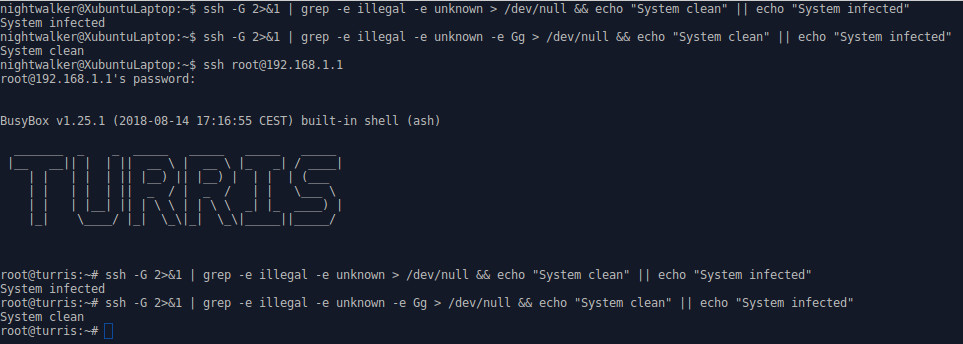

Thanks for the correct version of the command. I tested it at my Xubuntu laptop and ssh into my Omnia and ran the command there also.
First the old command and then the new one. In both cases infected with the old and clean with the new.

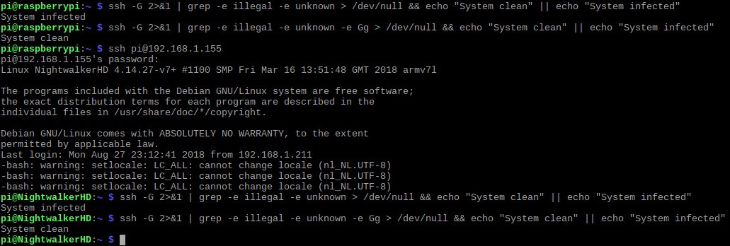

I did the test again with the fresh installed RPi and ssh into the Domoticz Pi with that one. Nothing to lose on the fresh installed Pi.
Result was the same for both. Infected with the old and clean with the new command.
https://www.walagata.com/w/nightwalker/Omnia/Ook_schoon.jpg
So, all the computers are clean of an ssh infection. I only have to re-install the Domoticz Pi to get rid of the botnet which is trying to call all these strange ip addresses.
